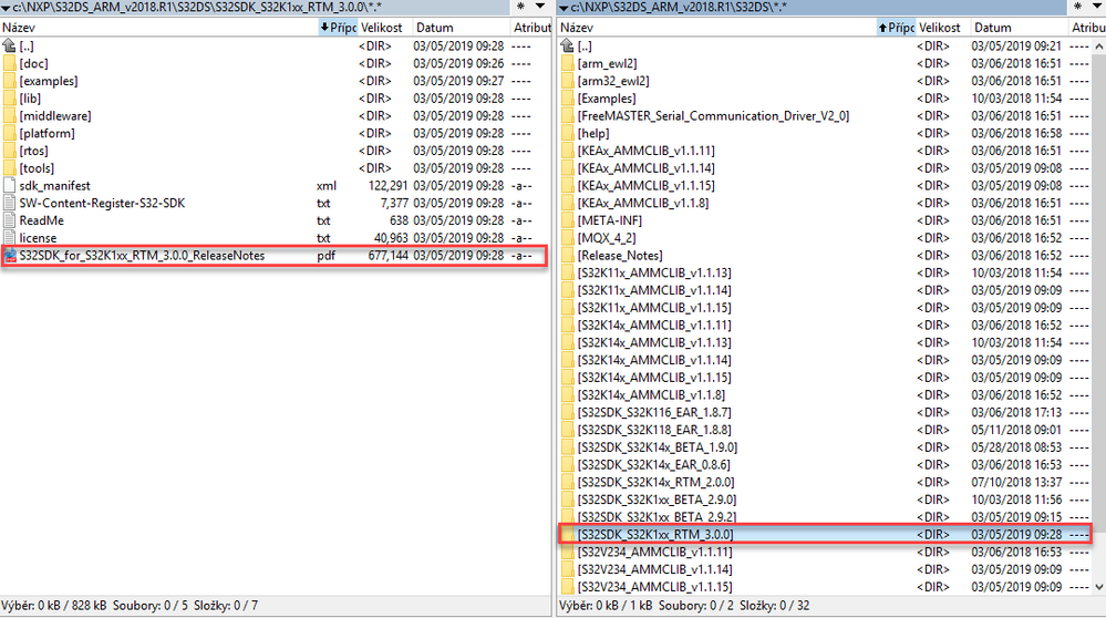

If you want to develop new application, I recommend use S32SDK_S32K1xx_RTM_3.0.0, which is the newest RTM version. If you have installed S32 Design Studio with newest update 9, you can see all SDKs in S32DS installation folder.
In these folders, you can find release notes for all versions, please see the figure below:
Please see the link below to download update 9, which contains latest versions of SDK.
