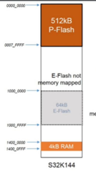

There is only one PFlash block (or partition) on S32K144.
And when the FTFC module is programing the block, the core must not access the block.
If the SysTick is causing this failure, it is because you have either the Systick handler in PFlash or the Interrupt vector table is in PFlash or both.

By looking at my configuration, I can see my P-Flash goes from 0x0 to 0x80000.
My liker file is configured to put the bootloader in the range of the P-flash.

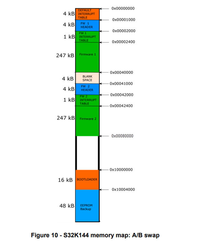

This configuration is explained in the AN12218 (S32K1xx Bootloader) application note, but there's is no mention of the issue. Do you recommend another alternative for the memory management of a bootloader?

The systick_handler is located at 0x4d14
Wich is in the P-Flash (Exactly as you said)
I assume that in your SDK application, the vector table is SRAM.
Therefore, I conclude that the vector table is not in SRAM.
I suppose this is why, in the AN12323 app note, the bootloader is put in the FlexMemory:
The bootloader memory map:
But, in the AppNote example, the Interrupt Vector is still in the PFlash:
Why is this not a problem?
Thanks.

The interrupt vector table (initial SP value, reset vector) has to be at 0x00000000, because out of the system reset the execution starts at this address (VTOR = 0x00000000).
I just tested the S32K144_FOTA_Bootloader SW (AN12323).
The startup.c file copies the vector table in SRAM before the application enables interrupts.
Also, the interrupt handlers are in DFlash as you mentioned:
