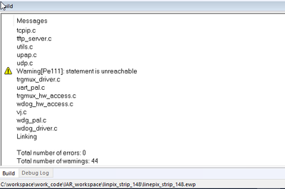

I use the S32DS 3.5 with IAR to complier and debug my project. now I meet the complier and link issue as below show:

I am sure the RAM size and ROM size is big enough. because my MCU is S32K148 100PINs
so I export my project according to the guideline as below:
then create the IAR project to complier and link it. it success!!!
what cause this problem??, two projects use the same .icf file.  S32K148_256_flash.icf(it is in attached file).
