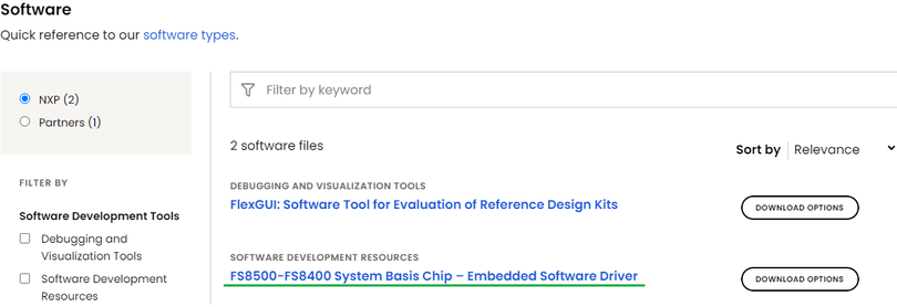

Hello NXP Experts...,
I am trying to writ 0x55(example) into SBC Memory0 register through SPI without DMA while writing into register i observed RX buffer data i 0XF000 for every write value into register (different data i wrote into this register) am seeing the same value in RX buffer i.e.., 0XF000
I followed the AN1233 reference for SPI Read and Write
you can see the source file attached
2 返答(返信)
1,096件の閲覧回数
TomasVaverka
Hello Chakradhar,
I am not familiar with the code you are using and do not support directly S32K MCUs, but I would recommend you to take a closer look at our  "FS8x Generic SW Driver with Examples". It includes, among others, the FS8x_WriteRegister function in sbc_fs8x_communication.c file.
https://www.nxp.com/products/power-management/pmics-and-sbcs/system-basis-chips/safety-system-basis-...
BRs, Tomas
1,090件の閲覧回数
scnaidu
the drivers are taken from S32k SBC fs85 only, one query is the SBC registers will only access through FS8x_Write and FS8X_Read. any other info if you had can you share, please
