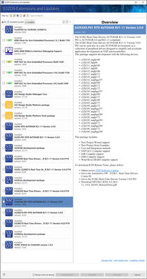

I have been trying to match what is in my installation and what is available in package manager. Unfortunately I am not able to match most of the packages so I cannot see how this method is going to work. Even if I could get an exact match for each package and download as a zip, it is not the fact that there are no other packages in the zip but more online that is the issue. So it is not clear what installation options would be available.
Here is my installation list, how can I replicate this on another machine, in 6 months time, when all of the online packages have been updated?

petervlna
I recommend you to download all these packages one by one and then use offline activation.
You can then install those on different PCs.
With the same activation key you can have it on 101 PCs.
Peter

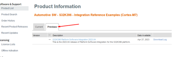

vmhb
As I tried to explain I do not see all of those packages of those same versions in package manager. Ergo I cannot download them all.
3,131 Views
petervlna
OK, this is because the versions are now in previous folder and maybe also not visible to public.
If you can list me the versions you do not see I can check if we can add them to the previous tab.
