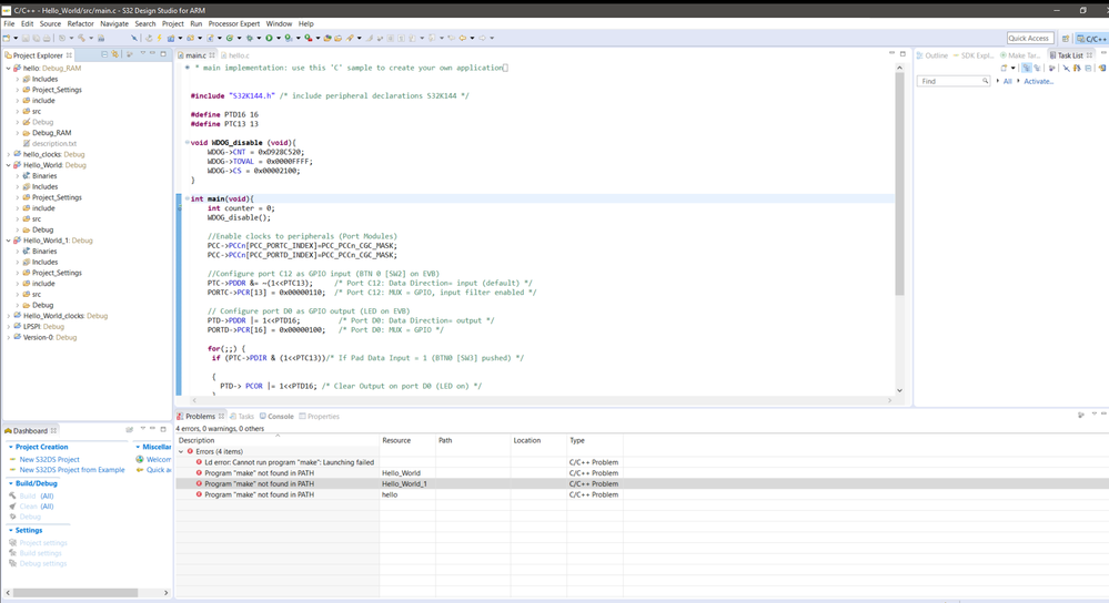

hello there,
Having trouble with building a project which was previous built in a different version of workspace. Now i am having trouble with using it. attaching the error screen shots
Please help.
thank you

Hi @VaneB
Thanks for that. onec i created new workspace and imported the projects from that previous workspace to this new one. Everythig worked like a charm.
Thanks for the help.
