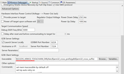

My MCU is FS32K144HAT0MLHT.  and I use PEmicro  to debug, but I found there is not FS32K144HAT0MLHT when I select device,  just have S32K144F512M15, S32K144F512M150N77P and S32K144WF512M8.                    I selected S32K144F512M15 and when I debugging, to check the value of variable, it said error target not available

Hi@Hanchun
please tell me what IDE you're using?
for example S32 for ARM 2018 debug pages.
don't forget to fill in the highlighted parts.

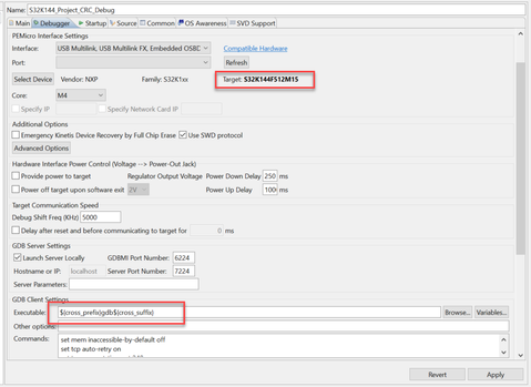

I use S32DS for ARM 2.2.  but how can I import FS32K144HAT0MLHT device.

Hi@Hanchun
chose S32K144F512M15 will be fine!

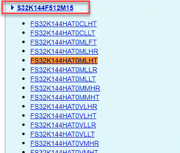

Hanchun
why choose S32K144F512M15 will be fine?  what is the reason?

Senlent
3,550 Views
Hanchun
hohoho   very good, thank you!
