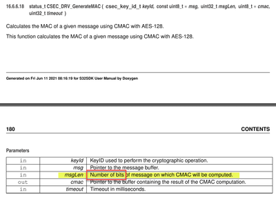

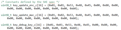

BrK_
Hi @lukaszadrapa ,
Thank you for reply but i guess the problem is not mentioned in the solution.
As you can see with additional pictures SHE spec vectors specified 8bit words. Also you can see test key, message and API which generate CMAC.
1,022 Views
lukaszadrapa
Hi @BrK_
It's number of bits, not bytes. Use length 128 instead of 16.
Lukas

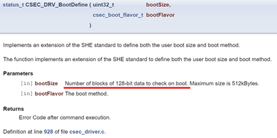

I have another issue.
I have an cmac value for a binary code file. Code size is 7308byte.
I defined this cmac value in my csec code and loaded it as boot_mac via debug RAM.
Then i debug the RAM again to enable secure boot.
The size variable that the CSEC_DRV_BootDefine function takes is defined as follows,
As a result, secure boot gives an error as boot_mac_key_missmatched.
I follows these steps :
* Operate flash partition for csec via Debug Ram.
* Define master_ecu_key, boot_mac_key, boot_mac via Debug Ram.
* Loade code into Flash.
* Define secure boot with CSEC_DRV_BootDefine  via Debug Ram.
* Reset device.
