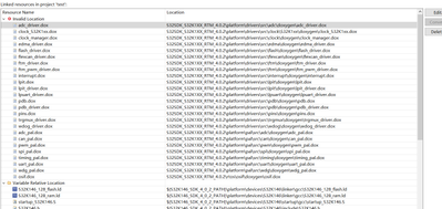

Thanks for your reply before, I have been able to reinstall now. But I had a new problem, a compilation error occurs. Current version of the toolchain is no longer supported. It is necessary to perform project migration to a later version, what should I do

I'm sorry that the project cannot be sent to you. Can you ask why this path is invalid? How should it be changed
