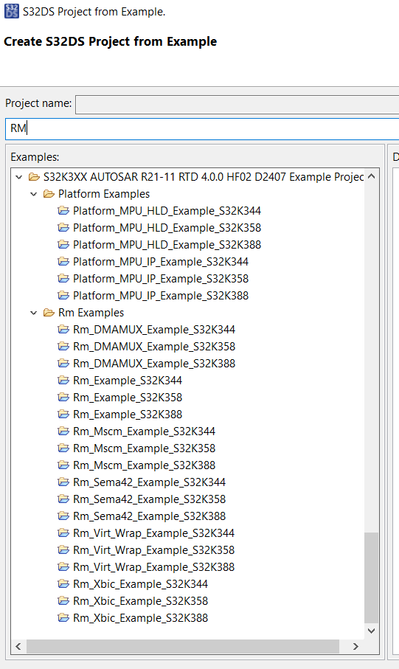

Hi NXP team,
We are working on S32K322 Micro based application.
Can you please provide example code for CDD -RM(Resource Manager)
Sub-Modules:
  1. MSCM (Miscellaneous System control Module)
  2. XBIC (Crossbar Integrity Checker)
  3. SEMA42
  4. XRDC
938 Views
danielmartynek
Hi @nkarthik,
There are many RTD RM examples, they are not ported to S32K322 though.
