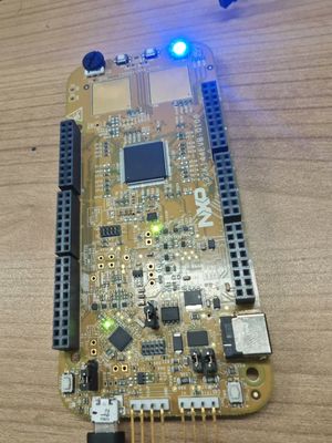

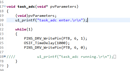

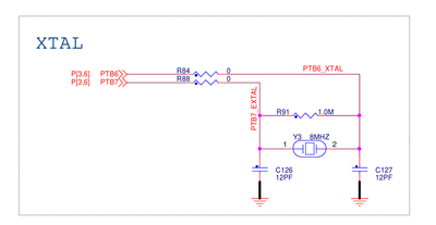

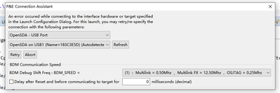

     After I configured the s32k144-EVB PB6 pin to GPIO and flipped it into my application, the OpenSDA debugger can't connect now. What should I do to reconnect to EVB for debugging?

Please try to use P&E Recovery Utility halt MCU and then download new code.
