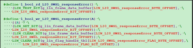

now I want to call l_bool_wr_LI0_SWSL_responseError(1) when LINCurrentState->currentEventId is SYNC_ERROR,FRAME_ERROR  CHECKSUM_ERROR IDENTIFIER_PARITY or BIT_ERROR occure.
Why do you want to implement like this? Because set the reponse_error bit to 1 is already handled in the stack code, so it's like re-inventing the wheel when doing like this

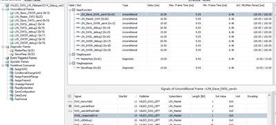

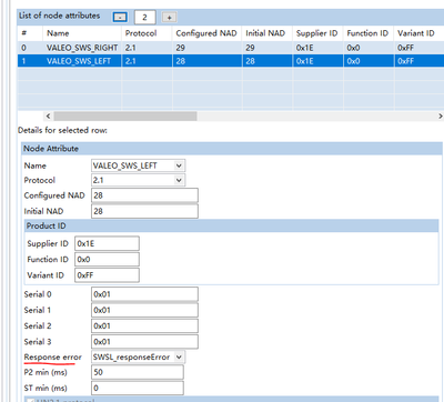

Show you our LIN ldf config
As your mean,we dont not modify the code.If there are some error
The SWSL_responseError shall be 1.So how to create the error to make SWSL_responseError  value as 1

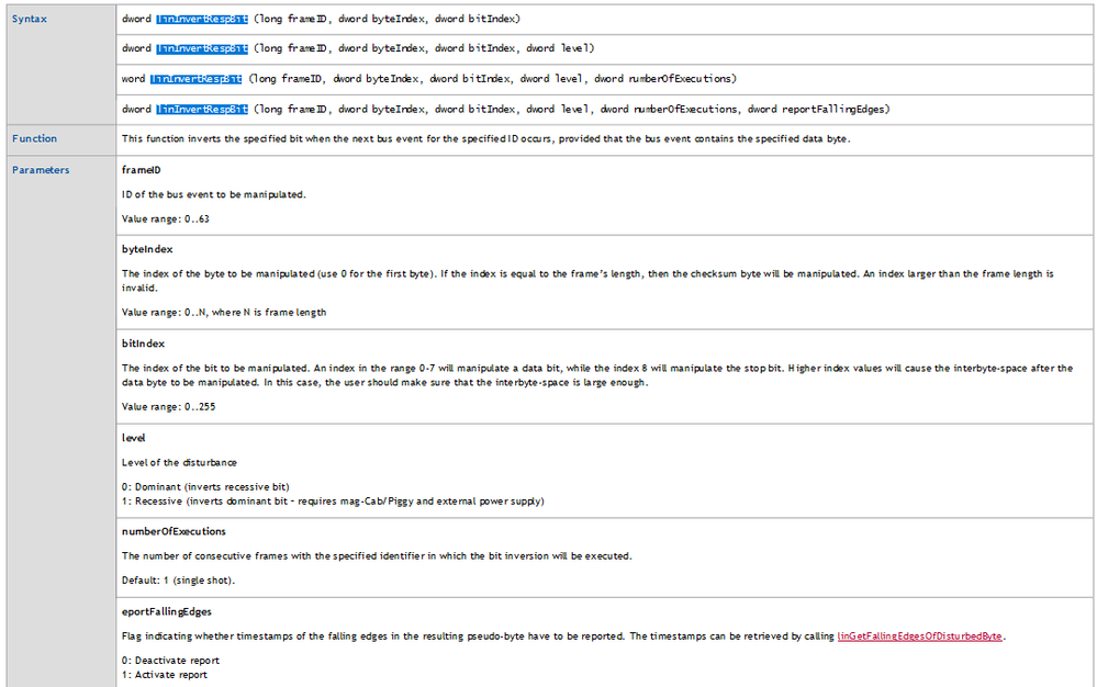

   1. we have Vector CANOE, do you know how to verify SWSL_responseError using this tool, we never do that.

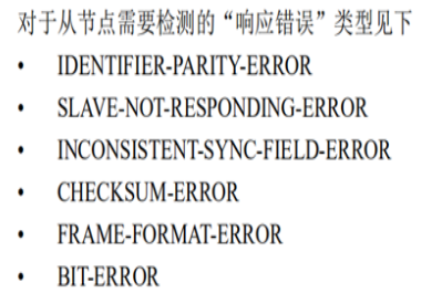

   2. when set SWSL_responseError, I don't see the BIT-ERROR, INCONSISTENT-SYNC-FIELD-ERROR and IDENTIFIER-PARITY-ERROR, does lin stack driver support these 3 errors?

1. You can write a script then import to the Vector CANOE. You can refer to the Vector CANOE helper. Below is one of the syntax to create a bit inversed (as a result a bit error will be occurred):
Please ask VECTOR for further support.
2. INCONSISTENT-SYNC-FIELD-ERROR and IDENTIFIER-PARITY-ERROR are not reported by the stack, the frame is just ignored according to the LIN specification:
BIT-ERROR is supported.

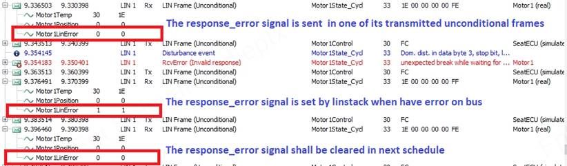

According to our LIN Stack developer, here is some information about handling the response error signal as below:
  • Each slave node shall publish a one bit scalar signal, named response_error, to the master node in one of its transmitted unconditional frames.
  • The response_error signal is set by linstack whenever a frame (except for event triggered frame responses) that is transmitted or received by the slave node contains an error in the frame response.
  • The response_error signal shall be cleared when the unconditional frame containing the response_error signal is successfully transmitted.
You can refer to chapter 2.7 of LIN_Specification_Package_2.2A.pdf to more detail.
One example about the response error signal is handled on bus:

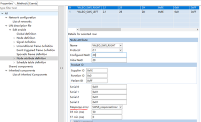

I have 2 slave node, named SWSL and SWSR, in each slave node, the corresponding respond_err named SWSL_responseError and SWSR_responseError, is it ok? or the name must be response_error?
[NXP] It is ok.
how does linkstack set response_error signal? does it need config previously ?
[NXP] The response_error signal has been defined in the .ldf file. The configuration tool(S32DS) will base on it to generate the configuration file as follows.
Whenever a frame that is transmitted or received by the slave node contains an error in the frame response the linstack(not user) will call to lin_update_err_signal() function to set.

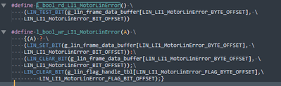

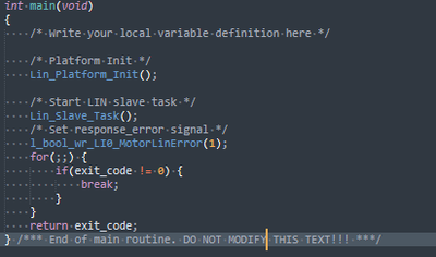

I'm afraid that you're having a misunderstanding. The reponse_error signal is handled internally by our LIN stack driver, and there is NO API to set/clear the reponse_error signal: The mechanism to set/clear the response_error signal is also handled internally and is explained in previous comment. In fact, we can "force" the stack to set the reponse_error bit each time the slave send the response, as below:
However, we don't recommend to do that, since it would break the whole stack: an response_error bit would be set even when there was no error, which is an abnormal behavior.
I have read again your question, and looks like you're asking for some functions which inject the fault into the bus, e.g. inject a bit error or a frame error,... Then unfortunately, our LIN stack doesn't provide any fault injection API. (The reponse_error bit only indicates whenever a fault was ALREADY occurred in the bus). You can use a test device (VECTOR Canoe, or NI LIN Interface,...) which support fault injection/bus disturbance.

How to set response error signal to 1 by using CANoe  to create checksum error , frame error and so on.
22,636件の閲覧回数
namnguyenviet
Hello @liuxing_hu,
We don't provide the CANoe tool, so we couldn't help you with this question. Please ask Vector to support this.

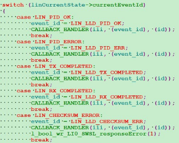

Retell my question, now I want to call l_bool_wr_LI0_SWSL_responseError(1) when LINCurrentState->currentEventId is SYNC_ERROR,FRAME_ERROR  CHECKSUM_ERROR IDENTIFIER_PARITY or BIT_ERROR occure.
plan A:
We call this function l_bool_wr_LI0_SWSL_responseError(1)

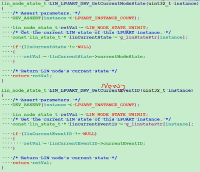

Plan B:
We want to write new function about get current Event ID in Lin_Ipuart_driver.c called by  APPL Level.Like this
Another question,we have not found IDENTIFIER_PARITY_ERROR or BIT_ERROR,how to genarete the error or where to find the error
