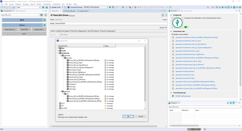

I add a FlexCAN IP module to code generator on s32ds for s32k3, but it doesn't generate any code file of FlexCAN. I've already generated some modules such as uart, platform, mcu, mcl etc. Should i create a new project?

What's the version of S32K3 RTD installed with S32DS3.4? Did you update the latest RTD?
I am using S32K3 RTD AUTOSAR 4.4 Version 1.0.0 and can’t reproduce the phenomenon you said.
S32K3 RTD AUTOSAR 4.4 Version 1.0.0.pngS32K3 RTD AUTOSAR 4.4 Version 1.0.0.png

I am using S32K3 RTD AUTOSAR 4.4 Version 1.0.0 also, but i generated some Mcal file. I uploaded the whole project(split into 2 files), please take look at the project if conveniently. Thanks a lot.

Sorry for late reply. I'm not sure why your project had always removed the FlexCAN generation files, however when we tried with a new project and added the same components, we couldn't see the issue. Please find the attachment. So maybe it's a good idea to try with a new project and add the same components.
