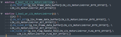

our  configuration tool(S32DS) not generates the configuration file as follows.
we have and use this as follow
we want to know how to use this to set/reset the  response_error signal.

namnguyenviet
Hello @liuxing_hu,
I'm afraid that you're having a misunderstanding. The reponse_error signal is handled internally by our LIN stack driver, and there is NO API to set/clear the reponse_error signal: The mechanism to set/clear the response_error signal is also handled internally and is explained in previous comment. In fact, we can "force" the stack to set the reponse_error bit each time the slave send the response, as below:
However, we don't recommend to do that, since it would break the whole stack: an response_error bit would be set even when there was no error, which is an abnormal behavior.
I have read again your question, and looks like you're asking for some functions which inject the fault into the bus, e.g. inject a bit error or a frame error,... Then unfortunately, our LIN stack doesn't provide any fault injection API. (The reponse_error bit only indicates whenever a fault was ALREADY occurred in the bus). You can use a test device (VECTOR Canoe, or NI LIN Interface,...) which support fault injection/bus disturbance.
