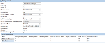

Therefore, I switched to FLEXCAN_DRV_RxFifo to receive CAN. It works and I receive several IDs as I expected, but the transmission does not work anymore.
Do you have any idea why the transmission does not work anymore when I use RxFifo?
I use mailbox0 for RxFifo and mailbox 1 for transmission. I configured CAN driver like below :
Should I consider another configuration?

7,973 Views
Milado
Hi ,
I changed the mailbox from 1 to 10 for the transmission and it works, now,
I don't know why it doesn't work with mailbox 1 & 2 ...
Milad
7,967 Views
PetrS
if RXFIFO is used then first few MBs are occupied by RXFIFO (MB0-MB5) and ID filter table. CLR2[RFFN] description shows this
So for default RFFN=0, there is 8 filter elements on area of MB6/MB7, so remaining MB that can be used for TX/RX starts at MB8.
BR, Petr

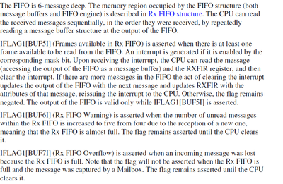

I saw in the S32 document that RXFifo has a depth of 6 messages.
Is it possible to increase this number?
 I want to receive 28 messages in one sending, but once I capture them, I only get 6 messages. To capture the others, I have to send them back.

PetrS
no RXFIFO depth is fixed, cannot be extended.
BR, Petr

Milado
According to the RM, RxFifo will be cleared after each reception. If I send more than 6 messages, the others will be cleared.
If it is not possible to extend the depth of RXFIFO, then is it possible not to clear the RXFifo buffer after receiving 6 messages? I mean keep the messages or put them on hold to retrieve them in another call.
Thank you,
BR,
Milad
7,848 Views
PetrS
if you receive 6 messages into RXFIFO it remains in RXFIFO until you read it and clear BUFI5 after each read out. Further message received which belongs to RXFIFO will be lost because there is no space in it.
BR, Petr
