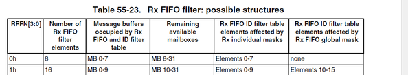

I use mailbox0 for RxFifo and mailbox 1 for transmission. I configured CAN driver like below :
Should I consider another configuration?

Milado
Hi ,
I changed the mailbox from 1 to 10 for the transmission and it works, now,
I don't know why it doesn't work with mailbox 1 & 2 ...
Milad
7,500件の閲覧回数
PetrS
if RXFIFO is used then first few MBs are occupied by RXFIFO (MB0-MB5) and ID filter table. CLR2[RFFN] description shows this
So for default RFFN=0, there is 8 filter elements on area of MB6/MB7, so remaining MB that can be used for TX/RX starts at MB8.
BR, Petr
