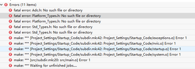

Using the example under the RTD path, I directly imported it into S32DS for compilation, but an error occurred. How should I handle this?
PATH:SW32K3_RTD_R21-11_4.0.0_HF_02\eclipse\plugins\Adc_TS_T40D34M40I0R0\examples\S32DS

If you want to test the RTD examples in S32DS, please click: File ->  New -> S32DS Project from Example -> S32K3XX AUTOSAR R21-11 RTD 4.0.0 HF02 D2407 Example Projects -> Adc Examples ->
Then follow the description.txt of the example:
3.1 Generating the S32 configuration
Before running the example a configuration needs to be generated. First go to Project Explorer View in S32 DS and select the current project. Select the "S32 Configuration Tool" menu then click on the desired configuration tool (Pins, Cocks, Peripherals etc...).
Clicking on any one of those will generate all the components. Make the desired changes (if any) then click on the "S32 Configuration Tool->Update Code" button.
