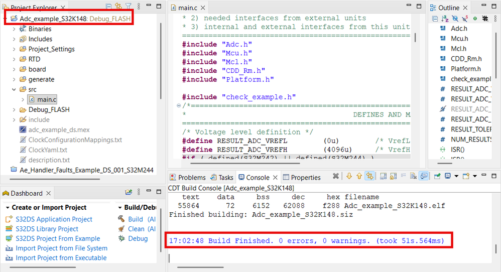

Thank you for your interest in our products and for contributing to our community.
Following your step-by-step instructions, after step 4 I built the project successfully:
Maybe we need to take a step back and check the installation.
Please an screenshot of your "Installation Details", which you can find in "Help" tab of the IDE.
