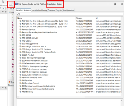

5,279 次查看
_Leo_
I refer to an screenshot like the following. I could be an scrolled capture o multiple captures to see all the installation details please.

5,053 次查看
_Leo_
Hi again,
I have reviewed your installation details, and seems correct. It's a pretty strange issue.
Could you please try a new installation please?
There is now available the S32 Design Studio 3.6.4 – Windows/Linux
