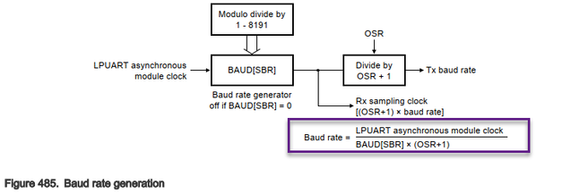

      There's a requirement in my current project. We need high speed of UART.
      From S32K3XXRM.pdf, page 772, it is written LPUART_0 and LPUART_1 is clocked by AIPS_PLAT_CLK, to support up to 12 Mbps while the core is running at 120 MHz, plz can you provide me an example source codes to have a test of high speed UART, if possible at speed of 6 Mbps ? I'd like to know the reg. config to set the baudrate. At my side, I use CH343G a usb dongle that may support up to 6 Mbps.

You can modify the LpuartFlexio_Uart_Ip_Example_S32K344 RTD example.
Select LPURT_0 and a custom baudrate in the configuration tool.
You would need to modify also the port, interrupt configuration etc.
But at 120MHz = CORE_CLK = AIPS_PLAT_CLK, this would be the baudrate configuration:

According to the Clk & Lpuart configuration :
AIPS_PLAT_CLK = 48 Mhz
LPUART asynchronous module clk = 7.3 Mhz
to get the baudrate of 115200, we have set
#define LPUART_FEATURE_DEFAULT_OSR (0xFU)
#define LPUART_FEATURE_DEFAULT_SBR (0x4U)
I compiled the source codes and plug the lpuart3 rx/tx wires to my usb uart dongle (CH343G).
I get the WELCOME_MSG_1 "Hello, This message is sent via Uart!" displayed in Putty. Good !
However we didn't get WELCOME_MSG_2 "Have a nice day!", not displayed in Putty ? Bad !
Then, I've changed
Then I changed manually in the file RTD/include/Lpuart_Uart_Ip_HwAccess.h this parameter LPUART_FEATURE_DEFAULT_OSR  to 0, normally, we should be able to run the same demo at speed of 1.8432 Baudrate, but after compilation and reload, nothing happens, nothing displayed in Putty ? Seems the uart clk is not configured ?
Plz, tell me what is wrong ?

It is important to set the system clock correctly.
Use Option A (core_clk 160MHz), and set all the clocks precisely.
RM, Section 24.7.2 System clocking configurations.
The RTD generated code should not be modified manually.
Check the LPUART registers after the initialization of the LPUART driver.
Keep in mind that not all the pins support such a baudrate.
DS, Table 25. GPIO DC electrical specifications, 5.0V (4.5V - 5.5V)
