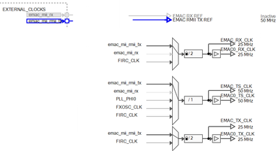

please refer to any S32K3's lwip example, where RMII works this way:
  • PHY (like TJA1103) works in rev-RMII mode and generates TX clock 50MHz for MAC (e.g. S32K3)
  • EMAC's RX clock input pin is not used
  • Internal EMAC RX clock (as well as TX clock) is derived from TX clock input with divider 2 -> 25MHz
S32K344 RMIIS32K344 RMII
