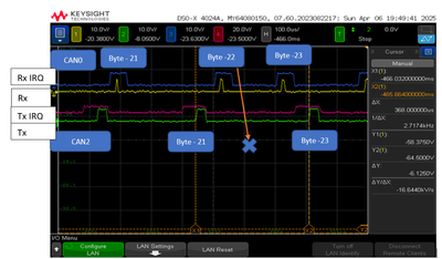

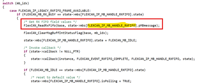

  1. As shown in the image below, we noticed that the "FLEXCAN_IP_MB_HANDLE_RXFIFO" index is always 0 for Rx FIFO management. Based on our analysis, data seems to be consistently written to the 0th index. Could you confirm if our understanding is correct?
  2. If our understanding is correct, could you clarify how the buffer management works in this case, given that the FIFO only appears to reference the 0th index? We are experiencing an issue where data is being overwritten, as shown in the image below.
If possible, we would appreciate it if you could share your email address so we can provide additional data and logs for further investigation. We are unable to share the log files here due to confidentiality concerns.
