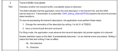

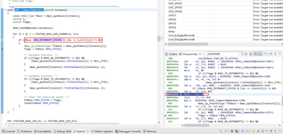

During the stability test of MCU (model S32K341), we found that the MCU restarted ab
normally. Later, we located that the last function entered before the restart was the Ethernet's common interrupt function. The specific reset point is as follows:

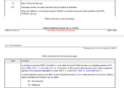

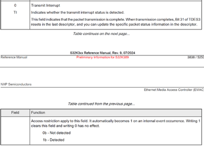

Through log records, we determined the values of the following two registers: DMA_Interrupt_status (0x40481008) = 0x00020000; The corresponding register description (indicates which major module of Ethernet generated the interrupt):
MA_CH0_Status (0x40481160) = 0x00000405; Corresponding register description (indicating the specific reason for the interrupt)
2360820408_3-1743507184652.png2360820408_3-1743507184652.png2360820408_4-1743507198399.png2360820408_4-1743507198399.png
Background description:
We are conducting a stability test where this board communicates with other boards via large-scale Ethernet communication. The recurrence probability of this issue is once every 48 to 72 hours, and it leads to an MCU reset. We are using the MCA version as shown in the figure below. In our code, there is a continuous transmission of 10ms periodic messages, and we are utilizing the FreeRTOS operating system. Additionally, there is another task performing MDIO read and write operations every 200ms.

Jerry_cao
Hi,Lukas
I may not have described it clearly before. My project has specifically identified a watchdog timeout reset. The breakpoint I mentioned earlier represents the state before entering the watchdog interrupt function. My current speculation is that my project frequently enters this common interrupt, which prevents normal feeding of the watchdog, resulting in a timeout reset.

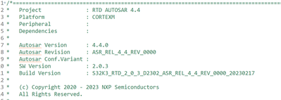

lukaszadrapa
I did deeper research and I found ticket ARTD-47931 which describes situation when the code can stuck in GMAC_CommonIRQHandler(). It was fixed in RTD 3.0.0. I can see that you are using older version, so my recommendation is to update the RTD.

lukaszadrapa
Well, the common interrupts were not masked by MMC_Rx_Interrupt_Mask and MMC_Tx_Interrupt_Mask registers in version 2.0.3.
In case of high traffic, the common interrupt would be triggered if counter reaches half or maximum value. This was not handled by the driver appropriately, the flags are not cleared in the handler.
In version 3.0.0, the interrupts are masked by this in init function:
/* Disable common interrupt from MMC */
Base->MMC_TX_INTERRUPT_MASK = 0x03FFFFFFU;
Base->MMC_RX_INTERRUPT_MASK = 0x03FFFFFFU;
Then the interrupts are not triggered.
It's possible that this will be updated in the future revisions (6.0.0 or higher) and the interrupts will be handled in different way. But currently it's fixed as described.
