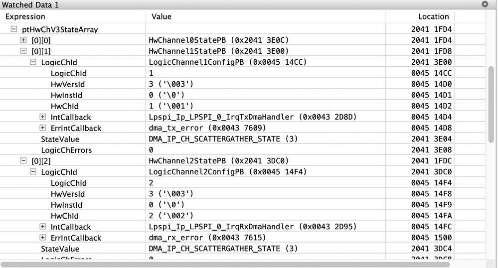

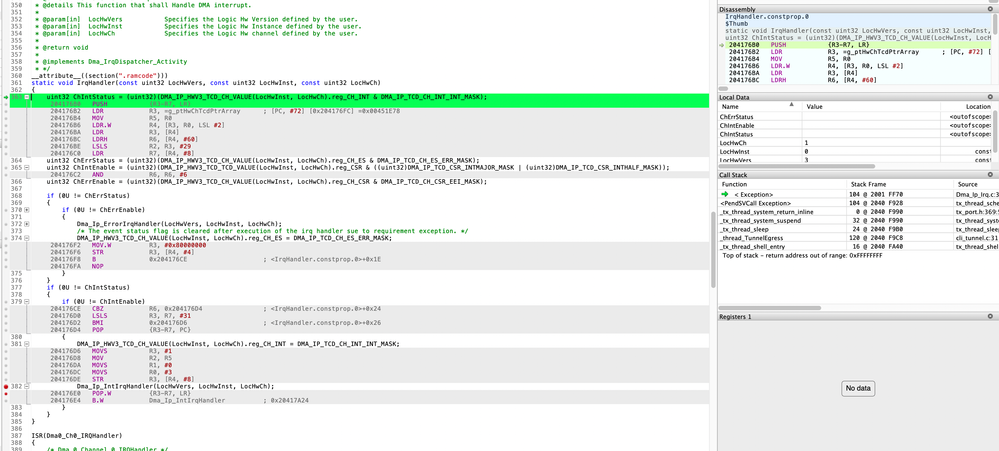

not_a_duck
@PetrS or @davidtosenovjan do either of you have any suggestions on what i can check?
one additional thing i have noticed is that the dma interrupt for the tx channel is being called repeatedly. it is supposed to call Lpspi_Ip_LPSPI_0_IrqTxDmaHandler callback but it never does.
Screenshot 2024-09-09 at 4.11.50 PM.pngScreenshot 2024-09-09 at 4.11.45 PM.png
13,276 次查看
not_a_duck
correction: `Lpspi_Ip_LPSPI_0_IrqTxDmaHandler` actually does get called but only once. and then never again
