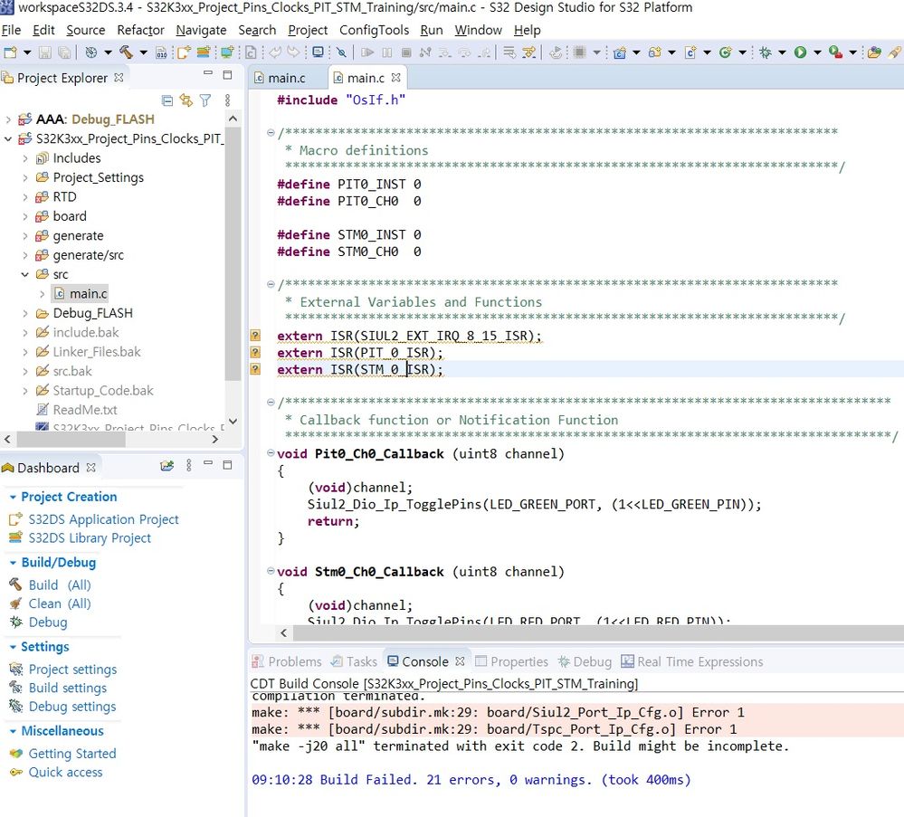

But I'm not solving the problem. I'm trying to set up a development environment, but if I create an example of s32k344 in the s32ds 3.4 version, only the main statement is created, and none of the related header files are generated.
Also, I would like to write the code in the way I used in the S32K144 instead of the DioConf_DioChannel_Digital_Output_LED_Q172, STD_HIGH).

But I get an error when I use an example because the files don't exist. Is there a workaround?
Also, I want to use the register directly rather than using the SDK function. Is there even one exemplified code?
I found a code that I can use by myself and wrote it, but I don't have a working PCB yet, so I don't know if this is a working code yet, but can you check if this is the code that interrupts pin 31 with FALLING EDGE and uses pin 18 as an output?
I post a picture of my problems when using codes and examples that I don't know if they work in the existing 144 method.
Also, if the file you provided is built unmodified, there will be an error. Is this a file that I need to fix?

Hi @Oido,
Please go over the "description.txt" or "ReadMe.txt" file before building the application:
You need to firstly select the project, and then click on either Pins, Clocks or Peripherals view. This will generate the configuration:
After opening the S32 Config Tools perspective, you can click "Update Code" which will generate the files on the project:
Julián
