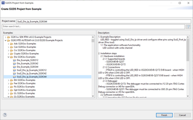

Development for applications in newer packages has been migrated from registers (as the S32K1xx's Cookbook) to application layer as LLD or MCAL. You can still implement projects the way you have been doing in S32K144, but there is no documentation for the S32K3xx's family.
Using S32DS3.4, you can refer to the RTD packages version 2.0.0 for S32K3xx, which include the libraries for all of the modules. You can import the Siul2_Dio_Ip_Example_S32K344 (there is no specific example for the S32K314 derivative):
This example toggles red LED from the S32K344 EVB, but you can reconfigure the output pin inside the "Pins" and "Peripherals" views. You can go over the HOWTO: Create a Blinking LED example project using S32K1xx RTD without AUTOSAR guide for some context in how to create a project with RTD. It showcases S32K1xx packages, but it is the same principle for the S32K3xx family. There is also the Pins and Clocks training with RTD.
You can download the RTD's from this page: Real-Time Drivers (RTD) | NXP Semiconductors

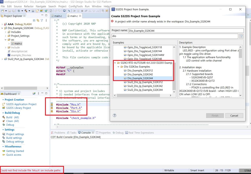

But I get an error when I use an example because the files don't exist. Is there a workaround?
Also, I want to use the register directly rather than using the SDK function. Is there even one exemplified code?

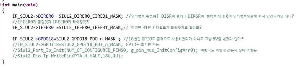

I found a code that I can use by myself and wrote it, but I don't have a working PCB yet, so I don't know if this is a working code yet, but can you check if this is the code that interrupts pin 31 with FALLING EDGE and uses pin 18 as an output?
I post a picture of my problems when using codes and examples that I don't know if they work in the existing 144 method.
Also, if the file you provided is built unmodified, there will be an error. Is this a file that I need to fix?

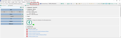

Hi @Oido,
Please go over the "description.txt" or "ReadMe.txt" file before building the application:

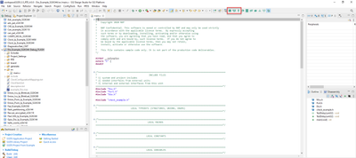

You need to firstly select the project, and then click on either Pins, Clocks or Peripherals view. This will generate the configuration:
After opening the S32 Config Tools perspective, you can click "Update Code" which will generate the files on the project:
Julián

Thank you for your answer, and thanks to you, I managed to operate the code related to the example on the s32k344 EVB Q172 board with PORT and PIT examples.
When I pressed SW5 switch using a combination of examples, I succeeded in turning on the GREEN LED and turning off the GREEN LED and turning on the RED LED after 2 seconds with the PIT.
But I don't like it this way: for example, Siul2_Port_Ip_Init(NUM_OF_CONFIGURED_PINS0,g_pin_mux_InitConfigArr0);
when I saw this phrase, I would never know in my life that
Siul2_Port_Ip_Init(uint32 pinCount, const Siul2_Port_Ip_PinSettingsConfig[]) //
PinCount and config[] should have NUM_OF_CONFIGURED_PINS0 and g_pin_mux_InitConfigArr0 variables in their place.
That's why I asked you how you can declare the register yourself.

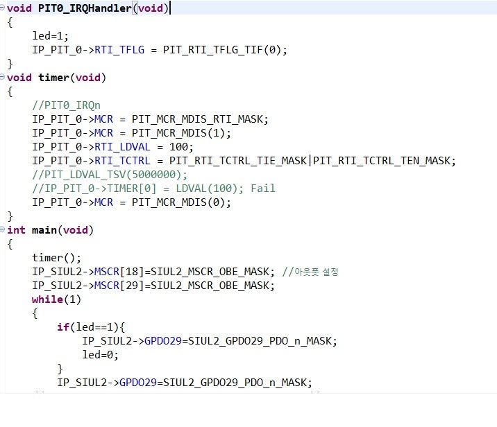

I declared the register myself, setting the PTA 18 and PTA 29 pins as output and making the 5V output go out.
Although PIT failed because it failed to find the format of several registers such as LDVAL, I'm sure I'll be able to find a way with help here.
S32K144 has various codes to declare registers in the cookbook, so other commands were guessed and written, but the S32K3XX series does not have a cookbook, so only hard-to-recognize example codes consisting of SDKs exist.

Unfortunately, there are no bare-metal examples for S32K3. Just those that use High Level Driver (HLD) or Low-Level Driver (IP) which you can find in its respective RTD for S32K3xx devices.
You can refer to the examples in the RTD package or the ones in community (such as Example S32K312 PIT timer Toggle LED DS3.5 RTD300 - NXP Community) for guidance.
There is a list of HOWTOs (S32DS - list of HOWTOs - NXP Community) with some guides for creating applications, as well as an application note for migration (AN13414: S32K1 to S32K3 Migration Guidelines).

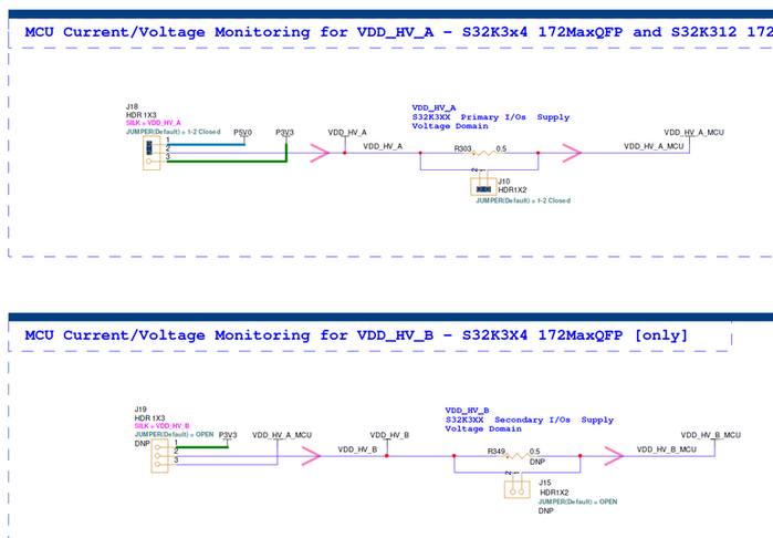

What are some ways to measure the current in real time? I know the method of measuring the current with a digital multimeter because the + and - lines come out, but the EVB board does not have a separate wire for measuring the current.
6,310件の閲覧回数

For current measurement, you may need to remove R303 and R349 and measure at J10, J15.
Julián
