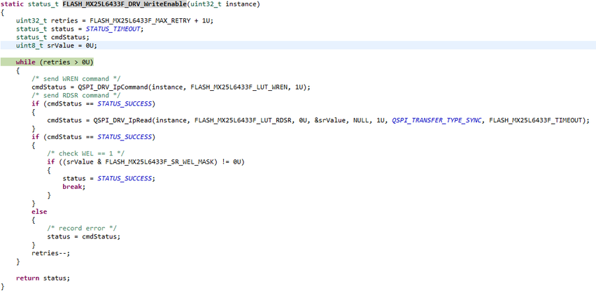

Yes, cross verified all the resistors are in place as guided, Here am seeing STATUS_TIMEOUT from "FLASH_MX25L6433F_DRV_WriteEnable" function.

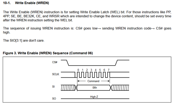

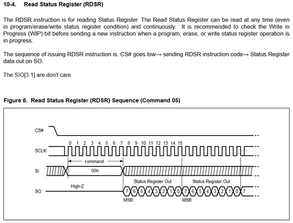

danielmartynek
This is the function:
It sends WREN twice and reads RDSR twice.
The STATUS variable is either overwritter to STATUS_SUCCESS if WEL is set by the WREN command or there is another error reported by the QSPI driver.
I reckon the issue is that WEL does not get set and the STATUS variable stays in the default STATUS_TIMEOUT.
You should see this on the bus:
2x WREN
2x RDSR
