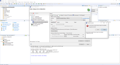

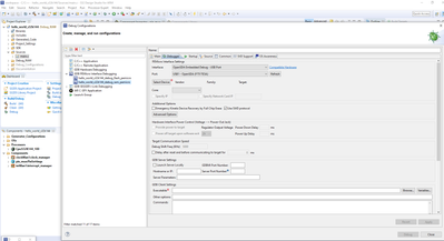

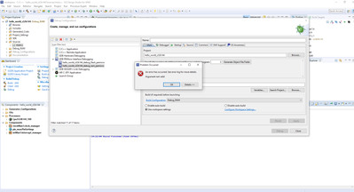

hi, iam working on S32K114 working with design studios and IAR compiler. when compiling example hello world program it compiled successfully but when debugging it says "An error has occurred. See error log for more details. Argument not valid"

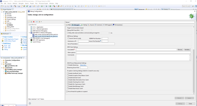

In debugger option GDB executable also missing(a lot of stuff is empty in the debugger option)
Here are the screenshots of the issue
pankajprasad100_0-1611031086653.pngpankajprasad100_0-1611031086653.pngpankajprasad100_1-1611031099826.pngpankajprasad100_1-1611031099826.png

Today I found this exact same problem. I open a project, select Run, then Debug Configurations. The screen comes up and I select my project under GDB PEMicro Interface Debugging. The error message pops up and the original configuration settings are blank. I can't change them back because the Apply button is grayed out, so they won't stick after closing. It makes no difference whether I am connected to any hardware or not.
