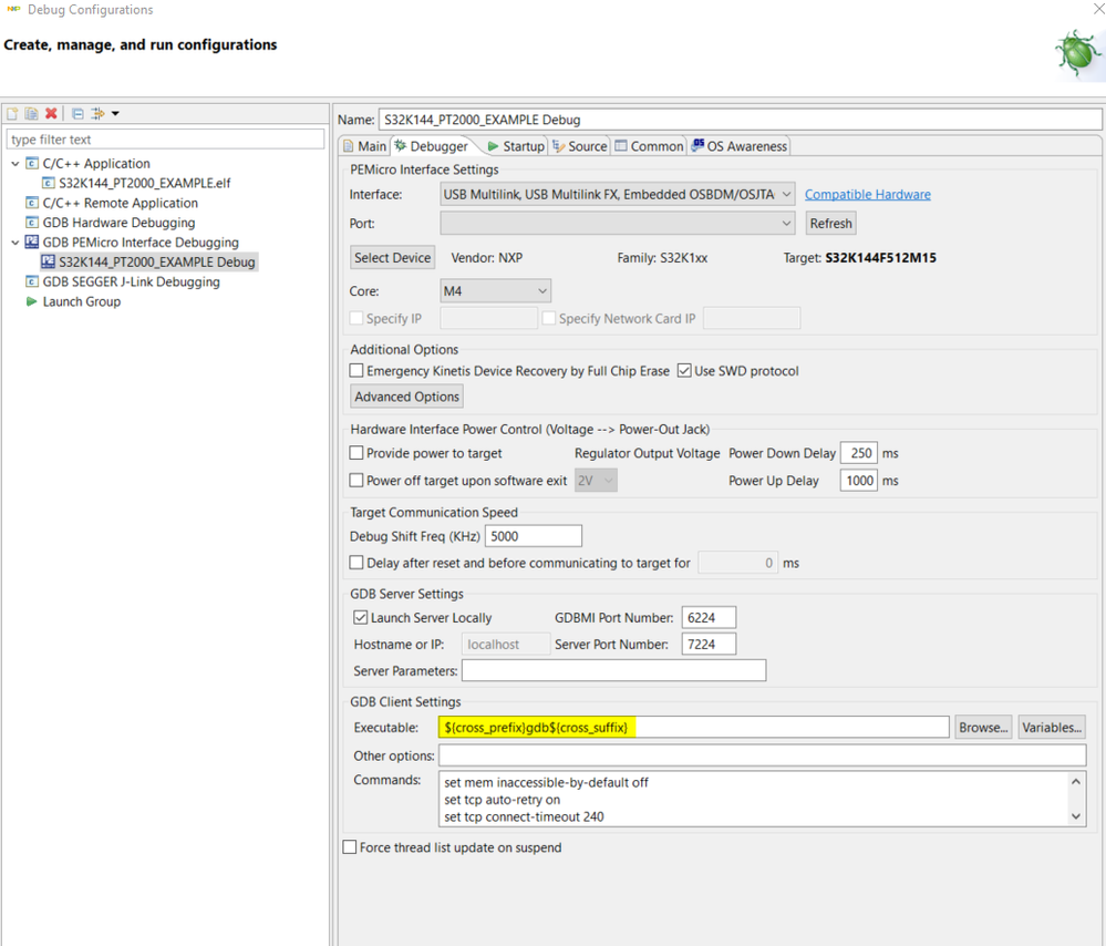

It is a version of the S32K144_PT200_EXAMPLE. It builds fine but I cannot debug it. I also could not communicate with the board using Freemaster.
I have two debug options:

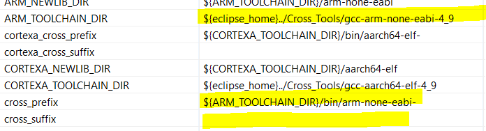

I was told to use the PE micro one and set it up as above. However cross_prefix and cross_suffix are defined as:

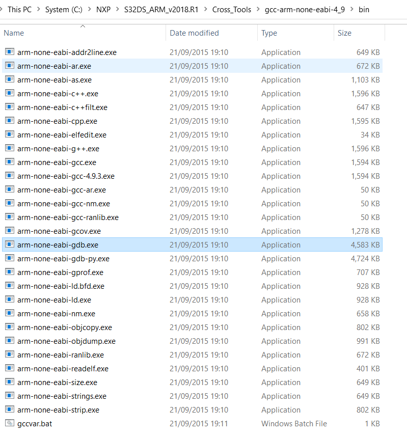

and I have a gdb on that path:
So what does that error mean? Program file does not exist? Maybe it cannot find the compile outputs - the .elf file or something? Maybe the search path is wrong, but where do I set that?

Solved!
Target .elf file was not specified:
