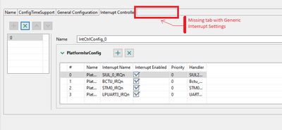

Not sure if  is relevant but I can nos access this tab. is this normal?

Not sure if this is relevant but I can not access this tab

It is not possible to import IntCtrl_Ip_ConfigIrqRouting because I do not know how to enable the following condition. I believe it might require activating a checkbox somewhere in the configuration tool, but I have not been able to locate it.
#if (INT_CTRL_IP_MSCM_SYSTEM_INTERRUPT_ROUTER == STD_ON)
Therefore, when I try to compile my ported application to the S32K311, the following error arises:

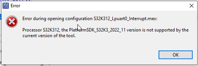

The example you sent cannot be opened with my IDE as shown in the image.
Any suggestion about how to solve the issue ?
