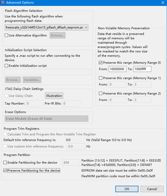

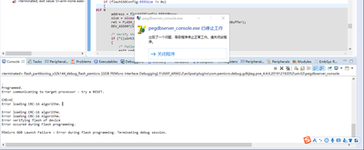

  When I debug a Example flash_partitioning_s32k144 from SDK and debug configurations as illustrated in following figure.
Then IDE appeared pegdbserve_console.exe has stoped as following picture show.
So, I was tried to fix it by update PEmcrio from Help->install new software->work with PEMicro - http://www.pemicro.com/eclipse/updates. After it installed done, things got worse when I tried to debug again.The GDB Server was not able to establish a connection to the target processor. And Flash an elf file also went wrong.
I'm sure the PE drive and s32k144 EVB is all right. I tried to reinstall S32DS, but again, once you preserve memory and perform a debug , you have a problem. It's fine when you Flash with preserve memory.

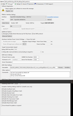

Can you show the whole debug configuration?
How do you preserve the memory?
Thank you.
BR, Daniel

Now I have updated the post. I'm sorry that I missed relevant pictures before. Last time I reserved the DFlash memory, and today I will still have the same problem if I reserved the PFlash memory.

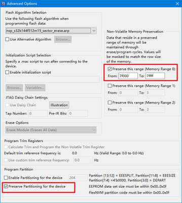

1. Unfortunately, the DFLASH (all backed up as EEPROM) data will still be erased by testing if I just preserve the partitioning. 

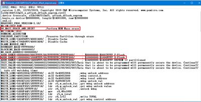

  In the flash algorithm file freescale_s32k144f512m15_pflash_dflash_eeprom.arp, as shown in the figure below, you can see that the Mass Erase directive might have been used, but I'm not sure if it had anything to do with it.
2. Surprisingly, if I just preserve the partitioning and used the Flash algorithm file nxp_s32k144f512m15_sector_erase.arp, the DFLASH data would not be erased. 使用nxp.jpg使用nxp.jpg So I want to know the difference between nxp_s32k144f512m15_sector_erase.arp and freescale_s32k144f512m15_pflash_dflash_eeprom.arp and whether all projects can be downloaded programs or debugged by nxp_s32k144f512m15_sector_erase.arp.
3. Another discovery when using nxp_s32k144f512m15_sector_erase.arp is that if you use Non-Volatile Memory Preservation to preserve DFlash, the download program still has errors. I think this is probably the reason why you can only use FlexRAM to access it.
If the PFLASH is preserved (for example, 0x0007f000-0x0007ffff), it performs fine, downloads the program successfully and can read the data previously written to the PFLASH.Pflash保存.pngPflash保存.pngconsole-log.jpgconsole-log.jpg
  In conclusion, If we can solve the problem with this,I want to confirm whether nxp_s32k144f512m15_sector_erase.arp can be used as freescale_s32k144f512m15_pflash_dflash_eeprom.arp

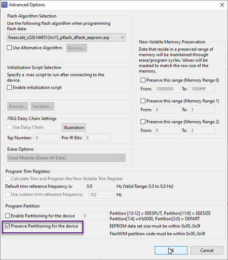

Yes, I have tested it with freescale_s32k144f512m15_pflash_dflash_eeprom.arp and the partitioning was preserved (DEPART register).
I already posted the configuration I used in this thread.

 This configuration, provided by you, ensures that FlexNVM(EEPROM) data will not be erased by simply checking Preserve Partitioning for the device and not preserving the memory range of FlexNVM?
Bob
7,821件の閲覧回数
danielmartynek
Yes, because once the FlexNVM has been partitioned for EEPROM, the FlexNVM flash block is not accessible for the masters on the bus like the core or the debugger, the block is not mapped.
It can't be erased by the Erase Flash Sector FTFC command.
Only by Mass erase or Erase All Blocks FTFC command or by removing CSEc keys.
All the above mentioned operations, however, remove the partitioning.
So, in other words, if the partitioning (see DEPART) is not removed, the EEPORM backup (FlexNVM) is not erased either.
