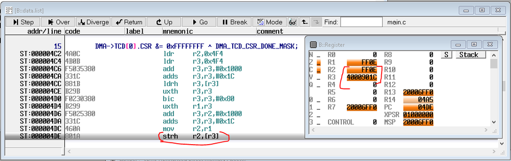

You can also double check used address and value when writing the TCD.CSR. It should be address 0x4000901C and the value depends on original value with cleared DONE bit. I can see in my debugger:
Or do you use memory protection unit? Are other writes to TCD working?
Lukas

Thanks. eDMA works my local now. I am trying to use CRC now. Still have two parts need your help.
