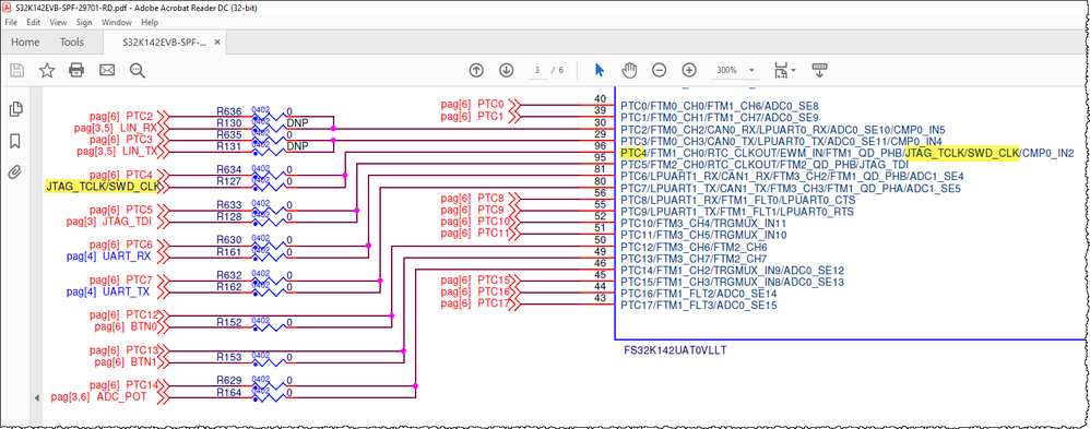

I've an issue with debugging :
calling "PINS_DRV_Init(NUM_OF_CONFIGURED_PINS0, g_pin_mux_InitConfigArr0);"
I'm getting disconnected from debug with "No source available for "__isr_vector() at 0x0" screen
The software on the S32KEVB still run without issue but I can't use debugger
The disconnection append in file "pin_port_hw_access.c",
In the function "void PINS_Init(const pin_settings_config_t * config)"
on the line "config->base->PCR[config->pinPortIdx] = regValue;"
for the 7th pin (previous pins are initialized without debugger disconnection)
It's seems to be PTC4, used for FTM1/ch0 peripheral
Any idea why I'm getting disconnectied from debugging, and how to avoir this ?

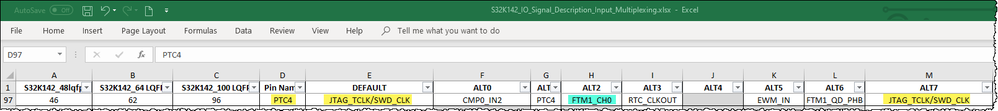

Robin_Shen
Hi Maxime,
PTC4 is default as debug pins(JTAG_TCLK / SWD_CLK), if you change it FTM1_CH0, then the debug connection will be error.
Did you consider use PTB2 as FTM1_CH0?
Robin
