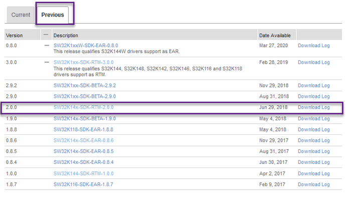

Open the link I sent you and go to the Previous tab
BR, Daniel

Hello both @nxf10035 @danielmartynek  ,
This is the link shared by you to download RTM 2.0.0.
https://www.nxp.com/design/software/development-software/s32-sdk/s32-software-development-kit-for-s3...
but only available versions in that link are RTM 4.0.0,RTM 4.0.2,RTM 4.0.3.
Please find the attachments for the Current and Previous version tabs in that shared link.
Please share the direct link of RTM 2.0.0, Thank you.
just now found the below reference link to download and install the RTM 2.0.0
https://community.nxp.com/t5/S32-SDK/Problem-of-Kinetis-SDK/m-p/1282252#M2183
