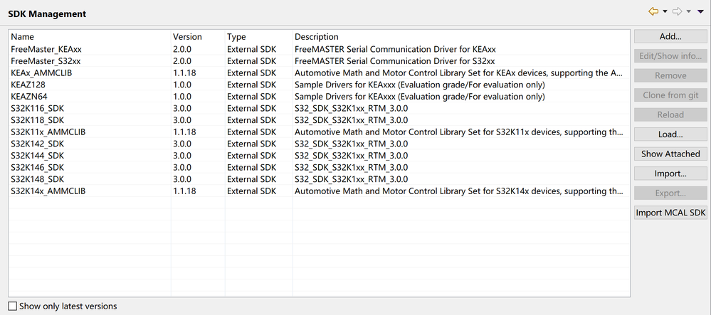

I download S32K1xx_unified_bootloader_demo_V1.0 from NXP's official website.When I complie the project,the S32DS recommend me to do this:
My S32DS version is "S32 Design Studio for ARM Version 2.2".The version of SDK I installed is shown below:
    What can I do to build this project with the correct SDK?
        1.Where can I download this version of SDK(Kinetis SDK)?
        2.How do I install the SDK on the S32DS?
                                                                                                                              Thanks!

Hi ByteWord,
SDK_S32K14x_12 is included in the RTM 2.0.0 version. Please, install Update 6 by following instructions in the link below into your IDE.
https://community.nxp.com/docs/DOC-340989
Probably you will need to follow offline installation.
After that you should see this repository in this path and it should work:
C:\NXP\S32DS_ARM_v2018.R1\S32DS\S32SDK_S32K14x_RTM_2.0.0\tools\pex\Repositories\SDK_S32K14x_12_Repository
Robin

ByteWord
HI,Robin_Shen,thank you for your reply!
My S32DS Version is "S32 Design Studio for ARM Version 2.2",but the "S32DS_ARM_v2018.R1_UP6.zip"  is for "S32DS for ARM Version 2018.R1 ".
Can I install the "S32DS_ARM_v2018.R1_UP6.zip" to "S32 Design Studio for ARM Version 2.2"? I didn't try to avoid serious error.

I have tried to install it in ARM2.2 and encountered problems. I suggest you install S32 Design Studio 2018.
