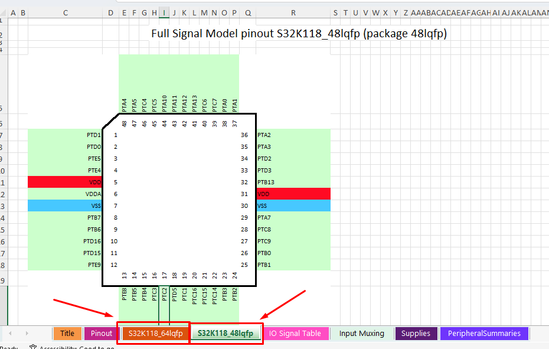

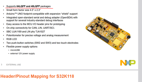

For the S32K118 Q048 Package, I can not find the Q048 pin layout in the refernce layout.
https://www.nxp.com/docs/en/quick-reference-guide/S32K118EVB-QSG.pdf

yousefdessouki123
Thanks for the response. However, I am looking for the header pinout layout. In the user guide, it is all about NXPS32K118Q064 not for NXPS32K118Q048. Kindly refer to the picture I have attached. I am looking for something similiar to it but for the Q048 package.

petervlna
Both use the same guide:
The differences on the pins you can find in the reference manual IO mux table for S32K118:
If the 48LQFP is missing pins compared to 64LQFP then it wont be also routed on the EVB, simply as it is not routed from micro IP to its package.
Peter
