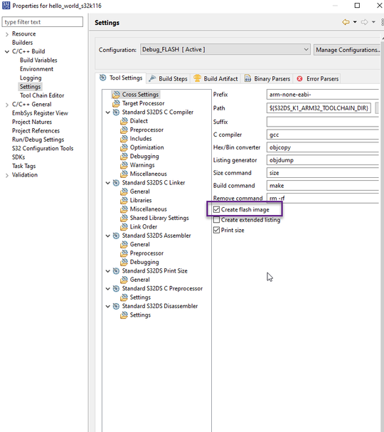

highway_joe
Hey Daniel, thank you for sharing the example projects.
I feel like this is a pretty dump question, but I am not able to run the project in the K116 EVB.
What I have tried to do (even it seems not right to me but I am lost here) is to put the elf file on the EVB via Windows HardDrive. As said, this seems not right to me, but I could not find an appropriate hint in the user manual nor in the community ...
I want to compile a srec-file on the project, but how do I do that?
Sry for bothering with that ... but is there a tutorial for running an example project in the Design Studio and debugging that with FreeMASTER?
4,488 Views
danielmartynek
You can simply load and debug the examples via the OpenSDA onboard debugger.
If you want to use an .srec file instead, open the properties of the project (right click on the project file)
Apply and close.
Again, open the properties.
Built the project.
You should see the generated .srec file in the Debug folder.
Regarding FreeMaster, can you please create a new thread in the FreeMaster community?
https://community.nxp.com/t5/FreeMASTER/bd-p/freemasterhttps://community.nxp.com/t5/Software-Forums/...
There are simple FreeMaster examples for S32K14x but not for S32K11x.
BR, Daniel
