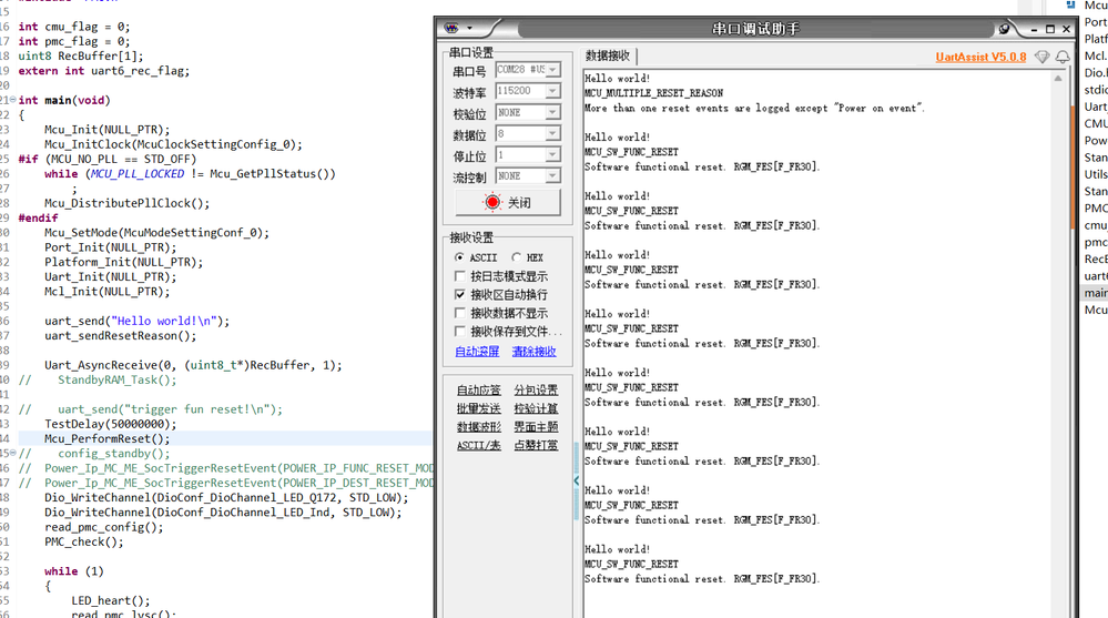

Why does my program freeze after executing Mcu_PerformReset() 8 times in a row? My functional reset Escalation threshold is set to 15, but it hasn't been reached.

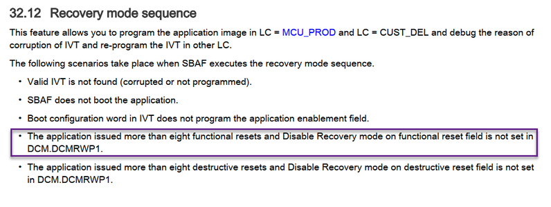

Hi @Pusoy,
This is expected if the Recovery mode is not disabled in DCMRWP1[22].
BR, Daniel
