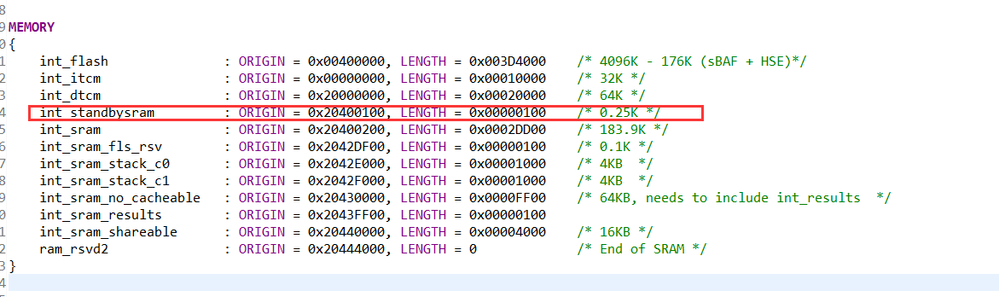

Could executing BIST damage the data in the RAM area? I have allocated a segment of memory in the RAM area for Standby RAM, but after executing BIST, I found that the data in the Standby RAM area was corrupted.
Yes, Memory BIST destroys RAM content as it fills it up with test patterns.
Therefore initialization is needed.
