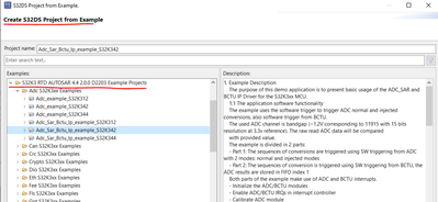

Hi@Simone9
please double-check if RTD 2.0.0 is already right installed.
below is mine, as you can see these demo in IDE
and open "MCTPTX1AK324_Triple_PMSM_RDB_M7_0.mex"

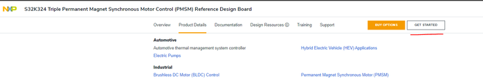

Senlent
Hi@Simone9
this demo run's on RTD 2.0.0 + IPCF 3.6.0
please follow the step of the link below.
https://www.nxp.com/design/development-boards/automotive-development-platforms/s32k-mcu-platforms/s3...

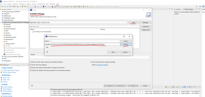

Simone9
Thanks for the reply.
I have tried to follow the suggested steps but have no problems with the inclusion of the required packages.
In the IDE's view of available extensions and packages there are only versions from 3.0.0 upwards of RTD.
I downloaded the ZIP of RTD 2.0.0 and tried to include it but apparently it failed.
I downloaded and installed the EXE of RTD 2.0.0 but again the outcome did not change.
I wanted to know if there were any special steps.
Thanks for the support

Senlent
Hi@Simone9
belowing is my install step, it works fine on my side.
