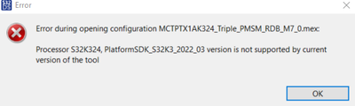

Simone9
I finally managed to get the project compiled and uploaded to the demoboard without any errors.
However, I wanted to look at the mex file to understand the configurations set in the various peripherals, but it gives me the following error:
 The IDE version is 3.5 updated 6.
Thanks for the suppor.

Senlent
Hi@Simone9
please double-check if RTD 2.0.0 is already right installed.
below is mine, as you can see these demo in IDE
and open "MCTPTX1AK324_Triple_PMSM_RDB_M7_0.mex"
