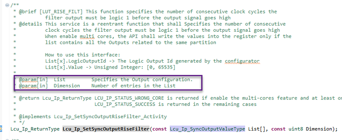

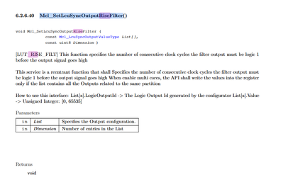

I encountered an issue while using the Lcu_Ip_SetSyncOutputRiseFilter function. I was able to configure the LCU successfully, but I needed to dynamically update the rise dead-time parameter through code using this function.
Although I referred to the documentation, I couldn't clearly understand where or how to pass the value for the rise dead-time filter. The function seems to take a list and its dimensions as input, but it’s unclear how this relates to configuring the dead-time parameter.
Could you please provide more details or examples to clarify this functionality?

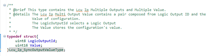

Hi @GaneshBhagwat,
You need to create an instance of this structure:
Lcu_Ip_SyncOutputValueType lcuOutputRiseFilter[6U];
lcuEnable[0].LogicOutputId = LCU_LOGIC_OUTPUT_0;
lcuEnable[0].Value = 1U;
lcuEnable[1].LogicOutputId = LCU_LOGIC_OUTPUT_1;
lcuEnable[1].Value = 3U;
lcuEnable[2].LogicOutputId = LCU_LOGIC_OUTPUT_2;
lcuEnable[2].Value =5U;
lcuEnable[3].LogicOutputId = LCU_LOGIC_OUTPUT_3;
lcuEnable[3].Value = 7U;
lcuEnable[4].LogicOutputId = LCU_LOGIC_OUTPUT_4;
lcuEnable[4].Value = 10U;
lcuEnable[5].LogicOutputId = LCU_LOGIC_OUTPUT_5;
lcuEnable[5].Value = 15U;
The Dimension paremeter is just the number of entries in the List
Lcu_Ip_SetSyncOutputRiseFilter(lcuOutputRiseFilter, 6);

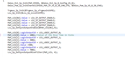

GaneshBhagwat
Thanks for the quick response. Yes I checked you solution now, its working. I checked it with the below code as you suggested.
