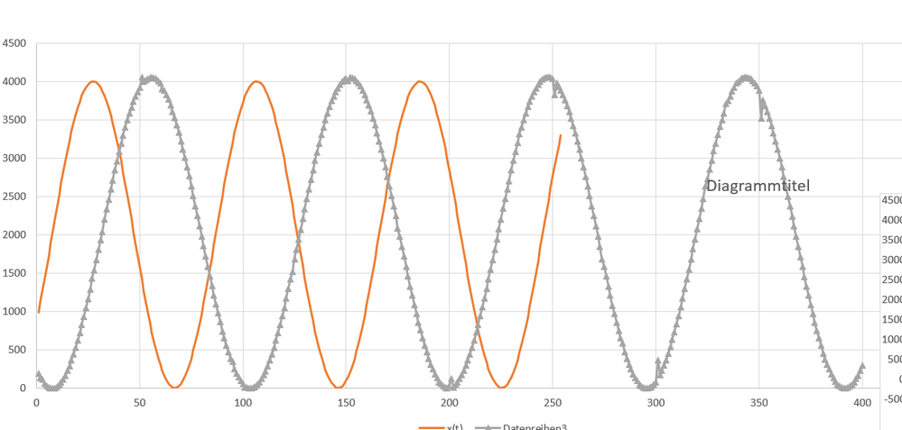

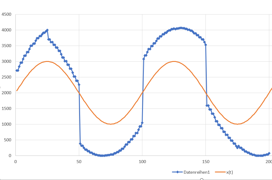

Hello ,
I have a question regarding the LPIT Triggered ADC and ADC Trigger DMA .DMA will create the interrupt after the 50 values .
The problem is it generates the Interrupt but i get the Waveform like this .I am giving Sine Wave as input .
the output(blue in color )  looks like this : Somehow i get this jump every 50 Values .
Could someone help me with this ?

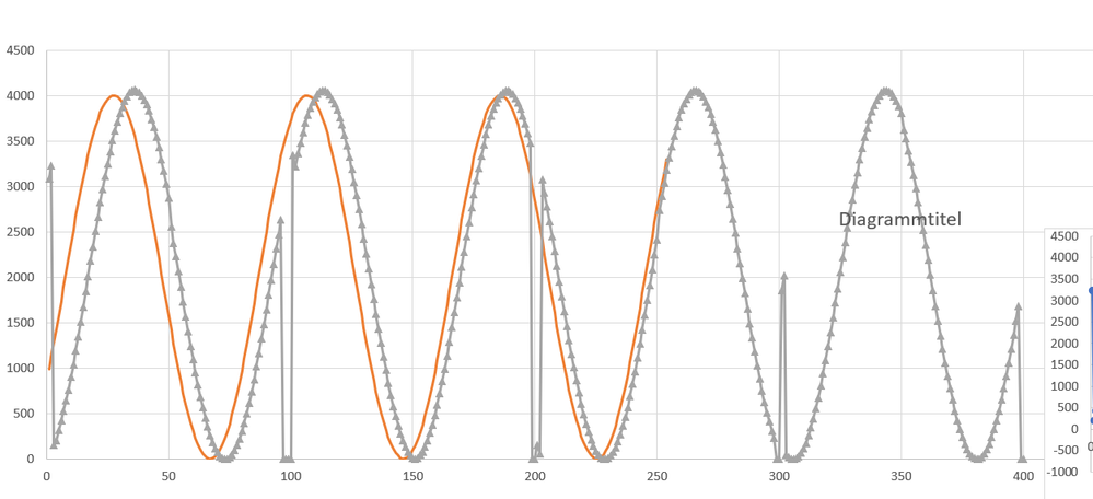

ushma_cholera
Hello Daniel,
I have now modified the DMA configuration and so i have better output but what is still missing is some values are having jumps at particular intervals .

i have enabled the intmajor and inthalf and major e link i have interrupt at every 50 values .when i have interrupt i have some values which out of the pattern .
i just do raw output no recalculation directly reading from the R[0].This is much better then the previous one but what is not understandable is some small jumps in between.

danielmartynek
Hello Ushma,
I don't any issue in the configuration.
You don't need the Continuous Link Mode though.
Do you use any other DMA transfers or do you trigger the same ADC module from a different source?
BR, Daniel

ushma_cholera
Hello Daniel,
I used the same ADC0 to trigger DMA .i trigger ADC with TIMER which LPIT .
ADC when finished trigger DMA .
I just tried with Removal of major Elink and ADC continuous conversion  mode .i have a better result but not the best .

danielmartynek
Hello Ushma,
Did you remove the Continuous Link Mode DMA_CR_CLM(0) as well.
