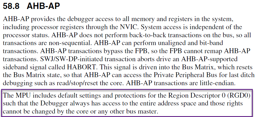

I want to protect an area of SRAM from being read by the DEBUGGER. How should I configure it
1,627 Views
danielmartynek
Hello 1260784871@qq.com,

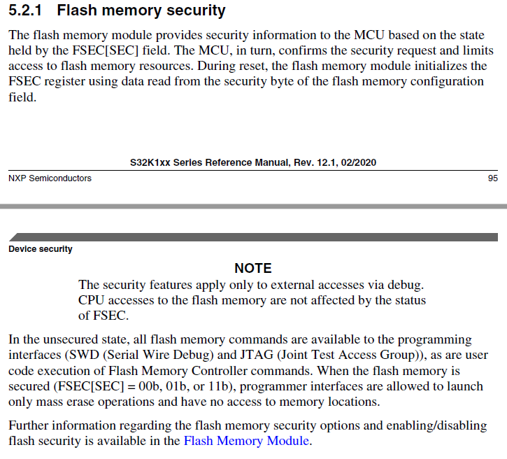

Regarding MPU, as you can see in the RM, the debugger has always access to the memory.
But you can secure the whole MCU
