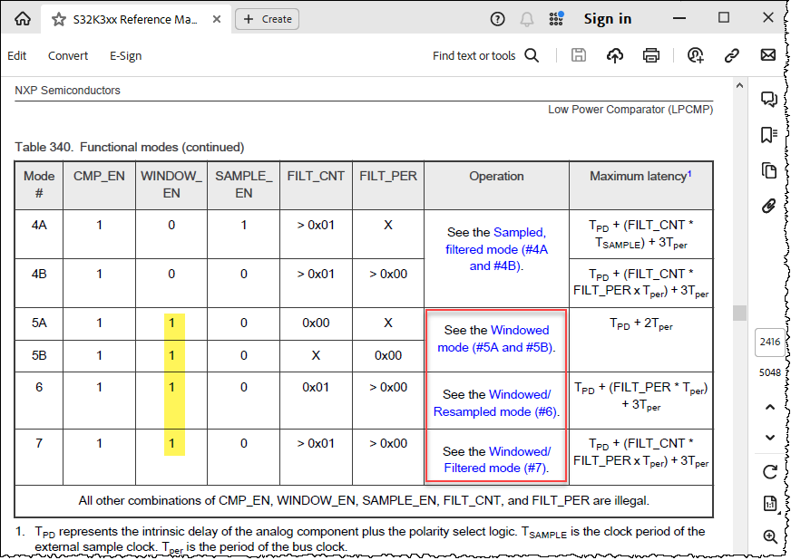

I have a LPCMP0 comparator with one input and a threshold reference voltage, but there is one more input feed back given to the comparator as a Window sample.
Could you please suggest how to configure and implement this third window input in comparator

Please read Table 340. Functional modes of S32K3XXRM(Rev8) first, and click to see which Windowed mode you want to implement:
Windowed mode (#5A and #5B)
Windowed/Resampled mode (#6)
Windowed/Filtered mode (#7)
