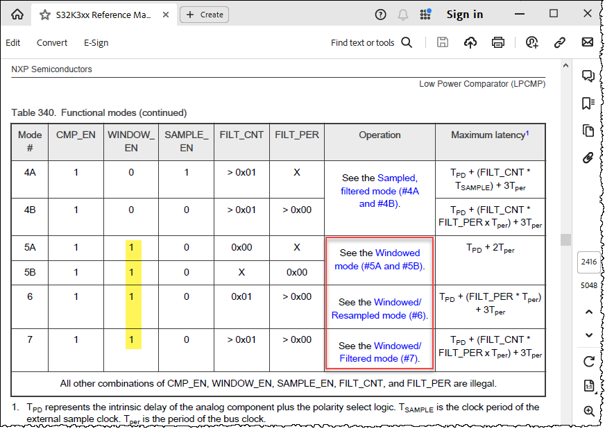

I have a LPCMP0 comparator with one input and a threshold reference voltage, but there is one more input feed back given to the comparator as a Window sample.
Could you please suggest how to configure and implement this third window input in comparator
Thanks and regards
1,370 Views
Robin_Shen
Please read Table 340. Functional modes of S32K3XXRM(Rev8) first, and click to see which Windowed mode you want to implement:
Windowed mode (#5A and #5B)
Windowed/Resampled mode (#6)
Windowed/Filtered mode (#7)
Table 340. Functional modes WINDOW_EN.pngTable 340. Functional modes WINDOW_EN.png
