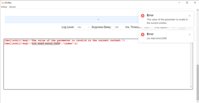

Asharm11
I had downloaded the unified_bootloader_demo_v2.1 which contains demo applications of bootloader.
I want to use LIN S32K142 bootloader, but the demo project does not contain the project for LIN S32K142, so I converted the LIN S32K144 project to LIN S32K142. On flashing the bootloader project on the NXP S32K142 100 pin board, the LED pins toggle but we get the following error on ECU bus tool.
What should be done to resolve this?

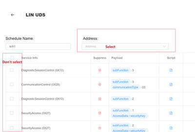

nxf10035
Hi, @Asharm11
      From your picture, I see that you only select download file process. Please note, the step as following:
1. Import process(JSON)
2. Connect hardware and config LIN node information
3. Select address of ECU BUS
For how to use the ECU-BUS, you can reference the user guide of ECU_BUS.
Suggestion you can open PLIN view and check the log of LIN BUS. It's better to upload the log when you met problems.

Asharm11
Hello @nxf10035
I followed what you said and i have been referring the ECU bus User guide there is nothing for how to use UDS on LIN and the error remains intact
so can we have a meeting regarding this issue
I am sharing the PLIN view Image as well as current error's image

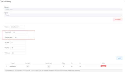

Asharm11
Hello @nxf10035
I changed the TX and RX ids to 3C and 3D respectively but I am getting the same result
I am attaching the snapshot for ECU bus tool setting and LIN tp settings
thank you

Asharm11
hello @nxf10035 ,
I tried with the IDs provided by you but I am getting the same error
and I am using the ECUBUS tool(0.2.13) ,could that be the issue?
I am attaching the snapshots of LIN TP settings
your thoughts would be appreciated
Thank you
