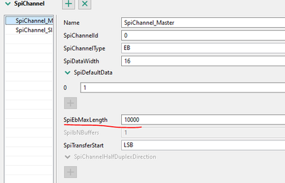

I have some definitions of the maximum size of the buffer data when communicating via SPI (256 bytes, 1024 bytes,...).
In SPI S32K drivers (on S32DS), Do we have a limitation for the SPI buffer size? Or Can we configure it?
I'm using S32K1xx, S32K312 with both autosar and non-autosar versions.
Thanks.

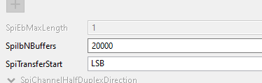

As far as I know, Autosar define 2 types of buffer: Internal and external buffer.
With Internal buffer, RTD limits Tx and Rx buffer to SpiIbNBuffer (max 65535) bytes. Please check define IB in file Spi_<>_PBcfg.c as below:
For external buffer, you can define your own Tx/Rx buffer and call Spi_SetupEB() to set buffer for your SPI channel. This function limits the size of your buffer as SpiEbMaxLength (max 65535 bytes)
