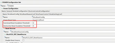

Hello
When using the DS tool to configure the Reset function, set [Functional Reset Escalation Threshold] to 0 in the [Power] component, that is, turn off the Reset Escalation Threshold function. Call the interface Power_Ip_PerformReset in the code to execute the Reset action. After 8 consecutive Resets, the MCU cannot be powered on.
Why can't the Reset Escalation Threshold function be turned off? How can I turn off this function so that the MCU can be reset infinitely?

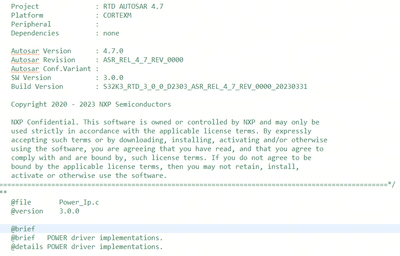

Simon-Liu
Contributor V
Hi @danielmartynek
The information in the picture below is the version of RTD I am using, thanks.
BestRegards
Simon

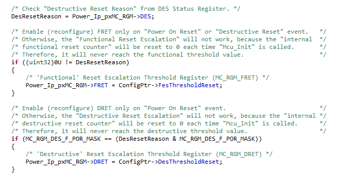

Simon-Liu
Contributor V
Hi @danielmartynek
I learned that the registers FRET and DRET are used to set the Reset Escalation Threshold, so I set these two registers to 0 before restarting to disable the Reset Escalation Threshold. When I set the Power Reset Type to FunctionalReset, the MCU can always reset by calling the Power_Ip_PerformReset interface; if I set the Power Reset Type to DestructiveReset, the MCU will be stuck and unable to operate after calling the Power_Ip_PerformReset interface Reset 8 times.
What is the reason for this?
Looking forward for your reply, thank you.
BestRegards
Simon
5,157 Views
danielmartynek
Hi Simon,
Your observation seems to be right.
The DRET register is cleared only after POR.
If you trigger a functional descructive reset, DES[F_POR] = 0.
But it should be cleared after any DES reset if the driver is configured with DRET = 0 (escallation disabled).
It has been reported to the RTD team,

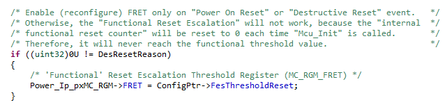

5,215 Views
Simon-Liu
Contributor V
Hi @danielmartynek
Thank you for your answer.
I checked your project and found that your code is the same as mine. In the Power_Ip_MC_RGM_ResetInit function in my project, there is also the processing of clears the FRET register if DES != 0. The attachment is my project. Please help to find out where the problem is.
