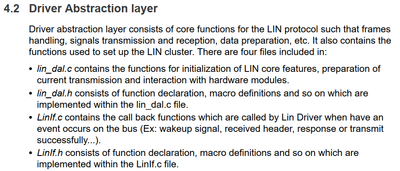

dongxun
Hello Daniel,
I hope this message finds you well.
I wanted to share that I have successfully resolved all the issues we discussed. Based on your valuable feedback, I have ceased all attempts to write to the registers and have focused on processing the received PID in the Linif.c file. Now, the system correctly handles whether to send or receive a response.
Additionally, I integrated the message simulation from CANoe, which allowed me to successfully read the LIN messages sent by CANoe and the data transmitted by the MCU as a slave on the debugger.
Thank you very much for your support and guidance throughout this process. I truly appreciate it.
Best wishes,
Dongxun

Hi @dongxun,
What NXP drivers / LIN stack version do you use?
  • The LIN Baudrate is configurable in the configurator of the LIN Driver, but it is limited by the clock selected for the LPUART module. How is the LPUART module clocked? And what is the value of LPURT_BAUD after LIN_Init()?
  • LIN Stack APIS: Please refer to LIN_UserManual.pdf that can be found in the LIN Stack Installation directory. Refer to the Lin Stack Slave example that uses the APIs.
  • BRK13: Do not modify the UART registers. This is done by the LIN Driver.
  • The UART driver does not use the FIFO.
  • I don't think the bus capacitance is the issue here, the baudrate must be fixed first.
